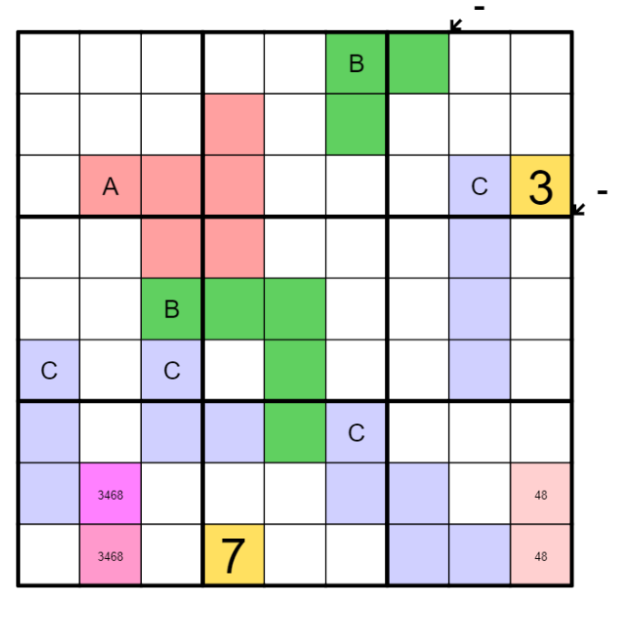

With those worked out, we can now get started on the sudoku. F and G can go in the grid right away. But what next?
A good place to start is to work out the prime factors of the numbers we need the regions to multiply to.
50 = 2 x 5 x 5
60 = 2 x 2 x 3 x 5
48 = 2 x 2 x 2 x 2 x 3
24 = 2 x 2 x 2 x 3
32 = 2 x 2 x 2 x 2 x 2
Of course these won’t be the exact numbers in the regions. Any 2 x 2 could be replaced by a 4, for example. But every time we combine two prime factors into a bigger number, we’re using one less digit overall. But we can balance this by adding 1s to a region, as multiplying by 1 won’t changing the total.
We also need to remember that any region that’s entirely within one row, column or box must contain different digits (the four-cell C region in column 8, for example, which needs to be 1 x 2 x 3 x 8 or 1 x 2 x 4 x 6). Also any time there are repeat digits in a region, they must be in different rows, columns AND boxes. That’s quite a big constraint.
We can see immediately that region E must be 4 x 8, although we can’t tell which way round they’d be yet. D must be 4 x 6 or 3 x 8. That’s not much of a start though!
A being 50 is particularly interesting. That’s 2 x 5 x 5. These numbers have to appear (you can’t combine a 2 with a 5, because 10 is too large for a sudoku). But Region A needs 6 numbers! So it must be 1 x 1 x 1 x 2 x 5 x 5.
There’s only one way to fit three 1s in that region without breaking the rules of sudoku. Doing so leaves only one way to place the 5s in different boxes, which leaves only one spot for the 2:
What next? The other numbers have a lot more possibilities, but with Region A filled, we can see that the 60 region below it can have at most one 1 in it. But 60 only has four prime factors. So it must be 1 x 2 x 2 x 3 x 5. There’s only one way to arrange these that doesn’t clash with Region A:
Now we can see that the three-cell C region to the left can’t contain a 1 or a 2. That means it must be 3 x 4 x 4. That 3 means region D must be 4 x 6, not 3 x 8.
